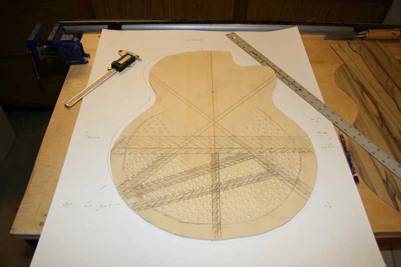

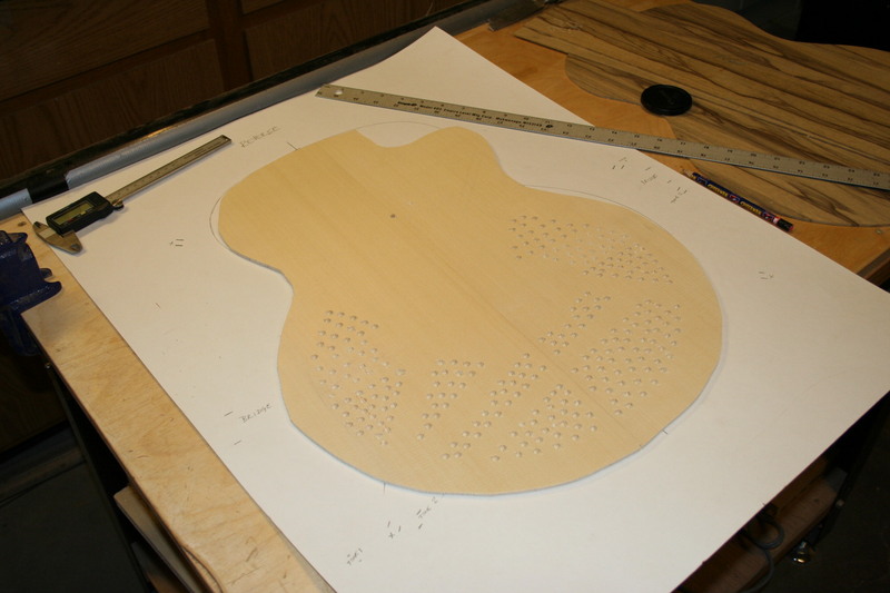

1. First I got the bottom top (bottom top??) Englemann Spruce cut and I marked exactly where the braces where going to be glued on.
2. the goal was to hollow out most of the lower bout area to reduce weight without sacrificing strength.
3. Instead of using Nomex to reinforce the hollow areas, I decided to route out holes in a honeycomb style removing some material while keeping the top strong. That allowed for less glue usage while utilizing most of the original top.
4. Top was then sanded to thickness and glued onto the redwood top.
The total top thickness is now at about .125" to .115" but the lower bout area, the area that's responsible for most of the top movement, is now about 40% lighter.
I left the center seam untouched, and the brace areas also to ensure and maximize strength.

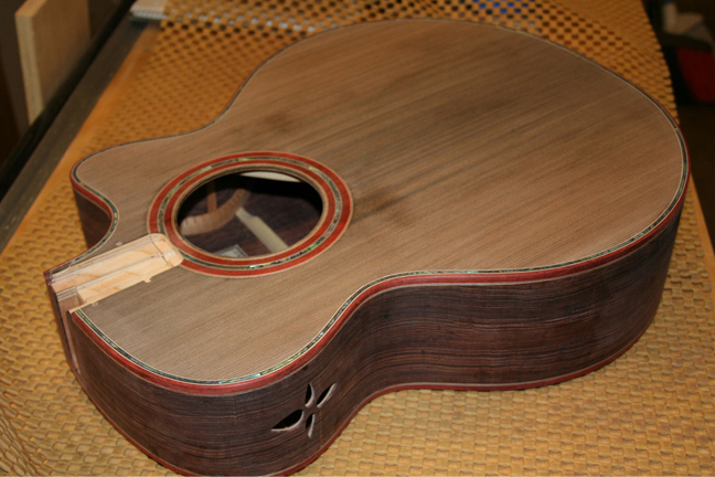

And here is the almost finished guitar!
Thanks for watching! peterm39031.9486458333

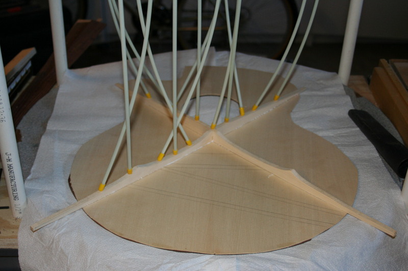

PostPosted: Fri Nov 10, 2006 3:23 pm
[QUOTE=Jim_W] Peter,
Did you leave the holes exposed on the inside? Very interesting.[/QUOTE]
Nope, if you notice closely the brace positioning is backwards to fit precisely in the correct place when flipping and glueing to the top.
Here it is:
peterm39031.9756365741

[QUOTE=Hesh1956] The possibility of running the grain 90 degrees off on the middle layer?
What do you think?[/QUOTE]
I think you've invented plywood, Hesh.
PostPosted: Sat Nov 11, 2006 9:17 am
[QUOTE=Hesh1956] Peter very, very cool and this is a great thread as well.
Have you considered the following.
Making a three layer top with the middle layer having the holes and many more of them. They would not need to avoid the brace locations since the other layers would be in contact with the braces.
Each layer could be much thinner and perhaps shoot for an overall thickness of .090 or less.
making 3 layers is a possible way to do it but you'd need another layer of glue...
If you ran one of the tops orienting the grain at 90 degrees you'd get a very stiff top with no lateral movement killing most of the top movement.... not the idea here!
PostPosted: Sat Nov 11, 2006 9:26 am
[QUOTE=peterm] [QUOTE=Jim_W] Peter,
Here it is:
Okay, now I am confused. If you don't leave the holes exposed on the inside, do you cover them with another layer of spruce?
PostPosted: Sat Nov 11, 2006 9:33 am
[QUOTE=Aoibeann] [QUOTE=peterm] [QUOTE=Jim_W] Peter,
Okay, now I am confused. If you don't leave the holes exposed on the inside, do you cover them with another layer of spruce? [/QUOTE]
No, the holes are covered by the top wood... in the case the Sinker Redwood. They are now in between the 2 tops....making those areas now hollow!peterm39032.7320023148
PostPosted: Sat Nov 11, 2006 9:42 am
I understand the top, it was the inside I wasn't getting.
So, there are three layers? The redwood on the outside, the holey spruce and the spruce on the inside?
PostPosted: Sat Nov 11, 2006 9:47 am
no Lillian, 2 layers... the top layer and the spruce which is partially hollowed.
PostPosted: Sat Nov 11, 2006 9:48 am
Ohhhh!!!! Now I get it... the holes don't go all the way through the spruce... So the holes are facing the redwood... Hence the 'double top' designation... I was wondering why it wasn't called a 'triple top'?!
'I see' says the blind man, as he falls down the stairs...
